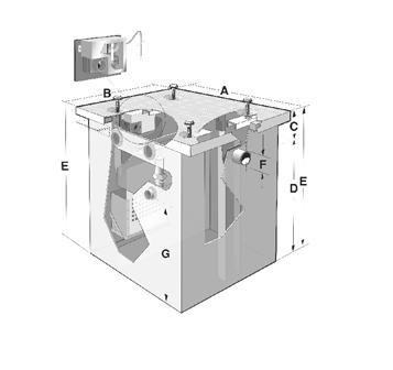

MIFAB® MI-E-O - ELECTRONIC OIL INTERCEPTOR
MIFAB® Series MI-E-O____ sanitary powder epoxy coated inside and outside fabricated 10 gauge steel electronic oil interceptor.
Unit to include: sediment bucket with perforated baffle near inlet, deep seal trap covered by lid, sewer gas stopper, securing bolt(s), removable baffle assembly and cross bar, stainless steel calibrated orfice plate, internal air relief by-pass, adjustable automatic draw-off assembly, double vent connection on each side, and steel powder epoxy coated, non skid rectangular lid(s).
