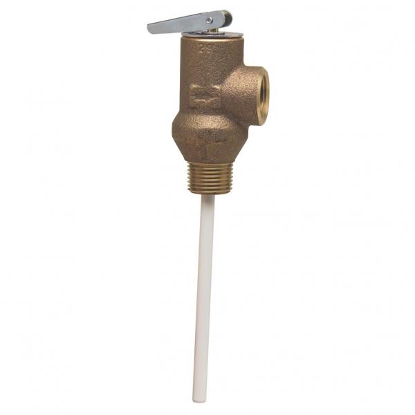

Series LF1L, LF1XL Temperature and Pressure Relief Valves are used in water heater and hot water storage tank applications to provide automatic temperature and pressure protection to hot water supply tanks and hot water heaters up to 15,000 BTU/hr. They feature an all Lead Free* copper silicon alloy body with NPT threaded male inlet and NPT threaded female outlet connections, unique thermostat with special thermo-bonded coating, and test lever. Series LF1L, LF1XL are CSA listed. Model LF1L has 2 in. (50mm) thermostat and a test lever. Model LF1XL has an extension thermostat. Temperature Relief: 210 degreeF (99 degreeC). Pressure Relief Range: 75 to 150psi (5.2 to 10.3 bar). Standard Pressure Settings: 75, 100, 125, or 150psi (5.27, 7.03, 8.79, or 10.55 bar).
