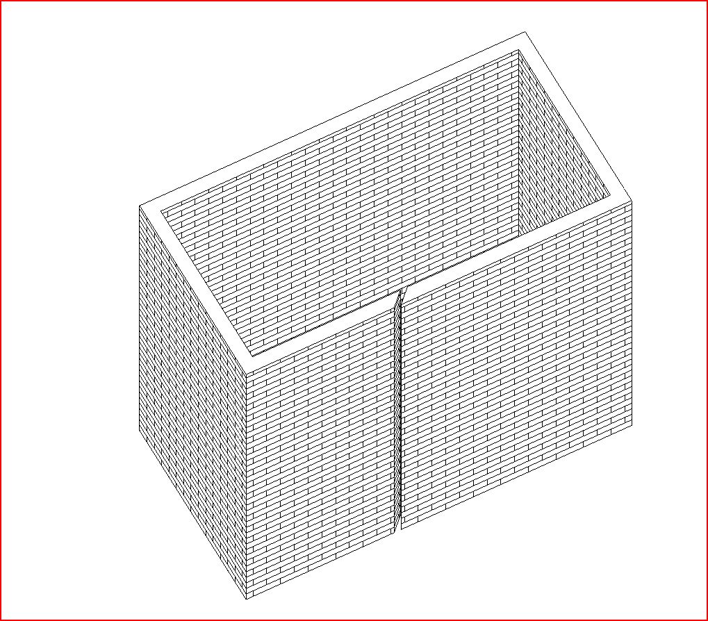

Draw your wall, go to a plan view. Click CREATE, choose WALLS and then OK. Give it whatever name you want. Choose VOID FORM, the VOID EXTRUSION. Set the properties (Start and End Height). Using lines, draw the void you want. Click FINISH SKETCH. Click the CUT GEOMETRY icon on the toolbar. Select the wall first, then the void. Click FINISH FAMILY. Note that you will have to use the PAINT command to "paint" the inside of the cut with brick. I am pretty sure that is what you are looking for-I attached a pic of what I did. Let me know if you have any problems. Cheers.

Thanks Lizard, that is what I was after. I'm still getting used to Revit. We have just converted from Architectural Desktop and it is a bit of a learning curve. Evan.
