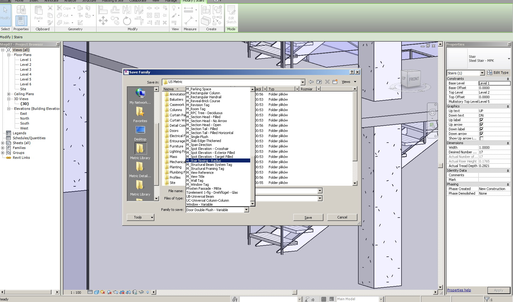

I had the same problem with exporting just families from the project and still can't do it right.
I'm doing "Getting Started Tutorial" from http://students.autodesk.com/?nd=revit2011_english, I have the files downloaded
but I'm creating the building in new file so there are some families missing.
When I open the ready file with building and follow Save as -> Library -> Family in the list I can't find what is in the project.
For example in project when I click on stairs it says -  "Stair Steel Stair -MPK" and the is no such family in the list. Not even anything similar while for example "Door Double Flush - Variable" is as well in the project as in the list of families.
What can I do to save those stairs to use them somewhere else? [These are my 3 first days with Revit]

Revit stairs, floors, walls, roofs and ramps are all system level and you can not save them as a family.  You can copy, paste them from project to project and you could copy, paste them into your project template.
