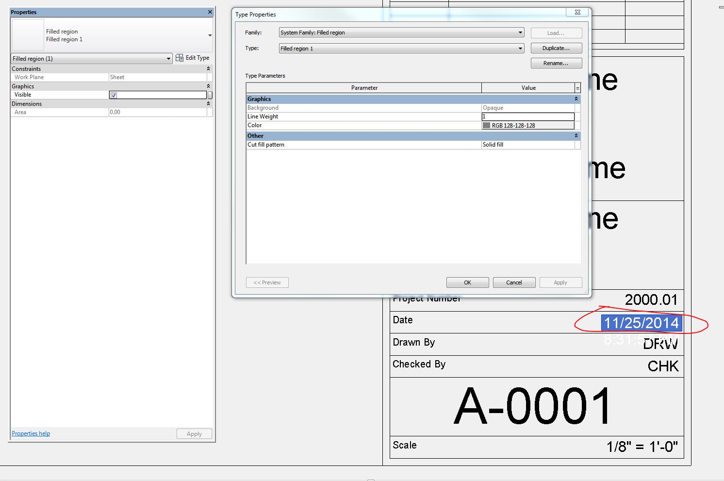

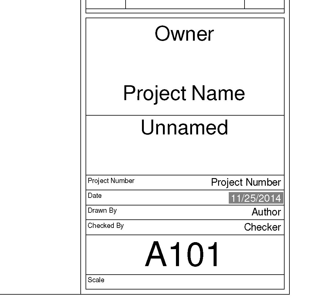

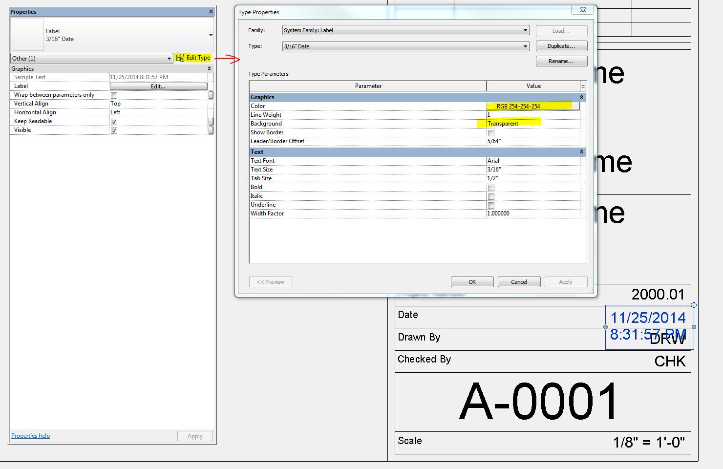

If you don’t mind hacking… in the title block family:
- Make label text almost white and transparent, pure wht will print as blk (pic 1)
- Create filled region any color you like (pic 2)
- when printing, set colors to gray scale, the printed output as per pic 3.
