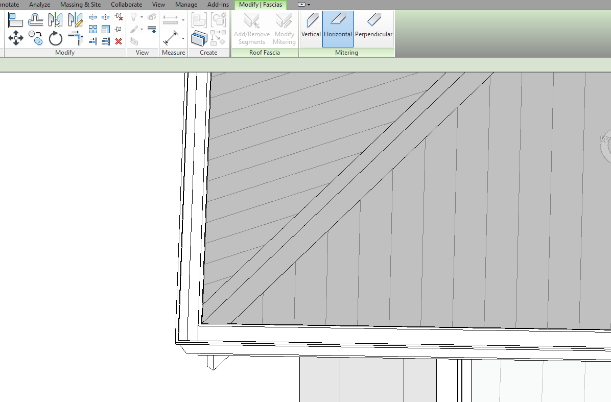

Fri, Jan 27, 2017 at 6:44:06 AM | Ridge Capping?
#9
martaw
Joined: Fri, Oct 30, 2015
0 Posts
I know this thread is quite old. Anyway for people who are still looking for answers... Creating a new profiles and using fascia tool for ridge cappings is the best way. Answering to lonre17 question. You can adjust end of your profile simply when you click at your fascia you will see option MODIFY MITERING on the up panel button. Then you choose option that fits your needs (in my case vertical) and click on your end of fascia
