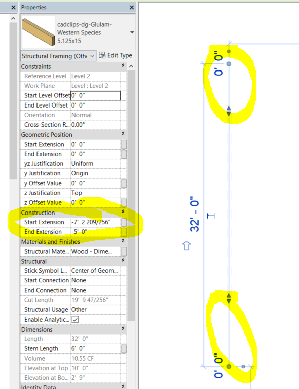

I am taking over a Revit-model from a previous employee in an architectural office, and I myself am fairly new to Revit. One thing I can|t figure out is why the beams in some places are being cut. As you can see in the photo the control point is stretching to both sides of the building, but not the beam itself. Any help on this?

The beams properties for Start Extension / End Extension are None Zero (negative in your case).
Just click the beam and look at the properties palette and locate 'Start Extension' and 'End Extension'. Set to zero to reset.
