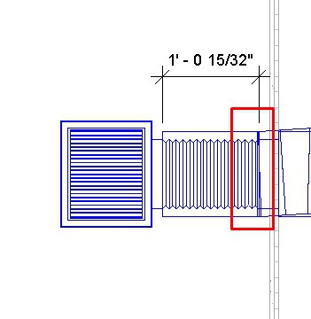

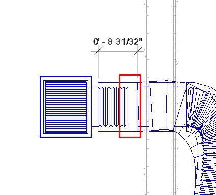

Why does the flexible duct disappear at minimum length?

Sounds like duct family can't process that length. Can you make it marginally larger - like 0.1mm or 1mm. Otherwise you may need to find or create a new duct with different parameters.
