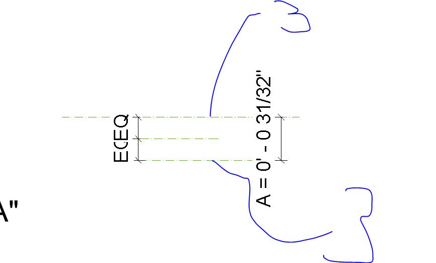

Dear experts;
I created a group of ref. planes with a parameter A and a central ref. plane.
I CAN move the whole thing dragging the CENTRAL plane up and down WITHOUT ruining the constraints.
I cannot repeat it. Tried different sequences.
Please see the image and the file.

Hi sllana;
Thank you for the reply.
The dimension between two exterior Ref. planes is a locked parameter.
In the example above Revit asks to unlock it.
Also I had it worked when one of the EQ-s is locked. But on the lower example they both are unlocked.

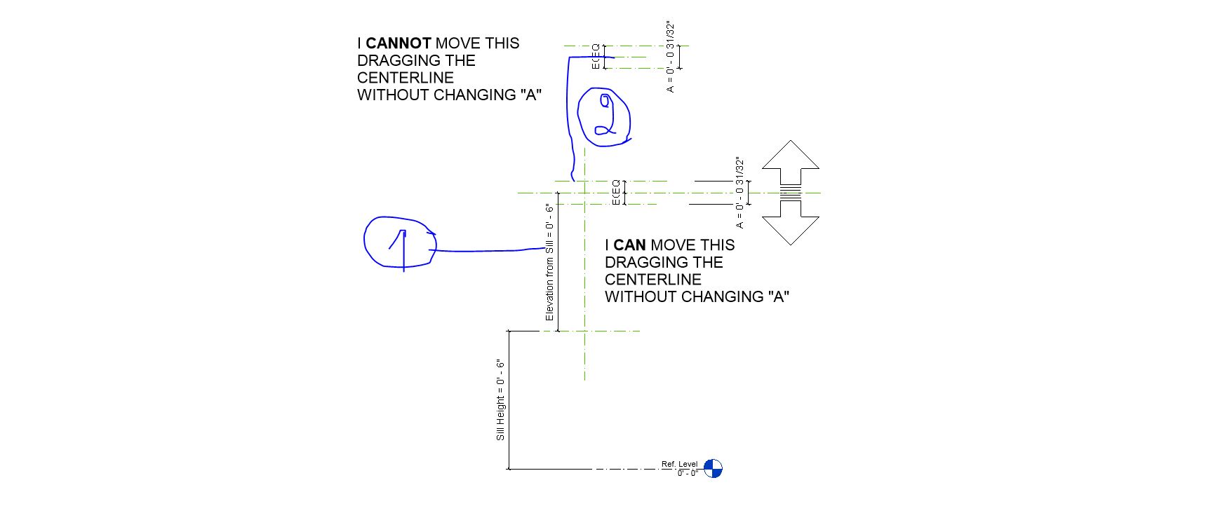

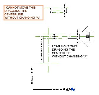

Tue, Nov 28, 2017 at 12:07:35 AM | Moving reference planes in a family
Elnazer2
Joined: Thu, Feb 18, 2016
0 Posts
4 Stars: 5 Votes
the lower one works because the reference plane is linked to a parameter if you attached the upper one to any parameter it will work ( Note 1 & 2 )
as for another workaround you can use the center line as a reference PLANE and the wing lines as REFRENCE LINES  ( Note 3 ) ,
for the solution you just suggested it works for dragging but you will be unable to change the value of A .
Sorry for the bad presentation on the screen shots snipping tool sucks !
hope this helps
I still cannot find the differenc, because all the three in both examples are PLANES, and the "wings" in both examples are linked by the locked parameter "A".
I think you suggest to change the wings from REF PLANES to REF LINES, but i need planes in this case. And it works in the lower example.
I still do not understand.
