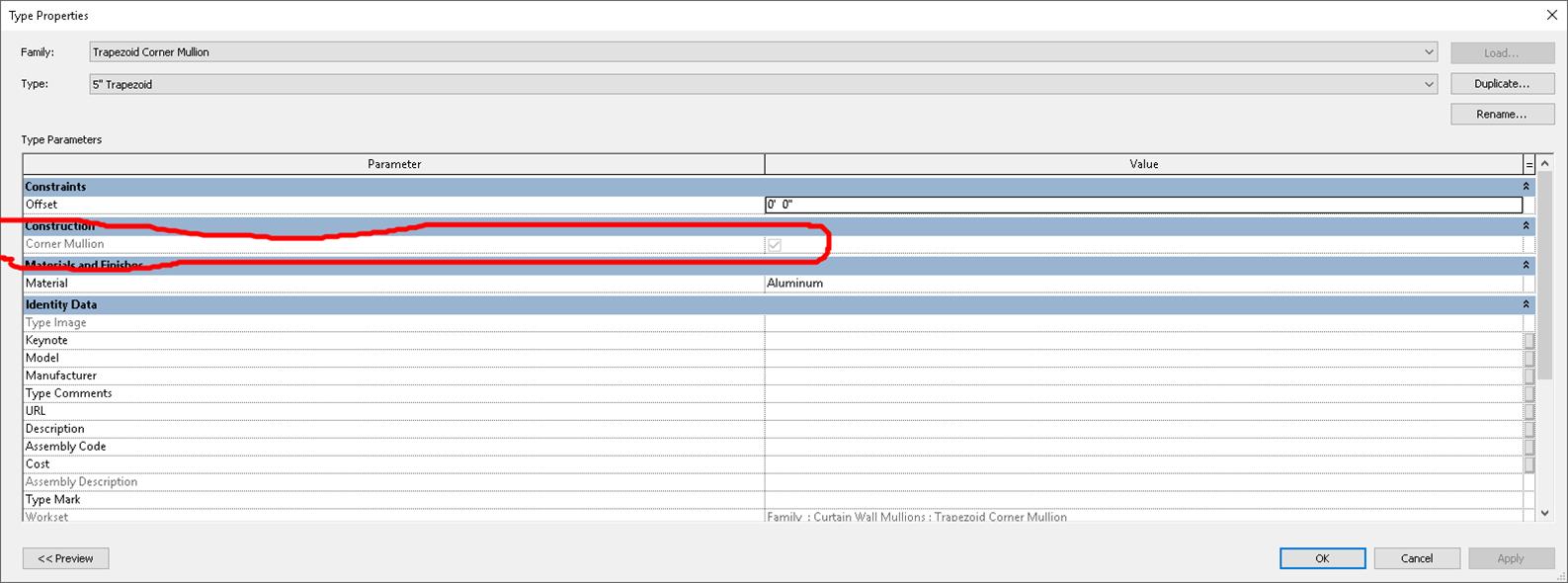

I made a new mullion profile, but I cannot figure out how to make an actual mullion from that.  All the system ones are greyout so they cannot be duplicated.  How do you make a mulliion from a profile?

Maybe this helps?
https://knowledge.autodesk.com/support/revit-products/learn-explore/caas/CloudHelp/cloudhelp/2016/ENU/Revit-Model/files/GUID-8FED5A73-7C70-45A6-99D2-BE1DE5E8CB49-htm.html

Well that is getting there.  At least now I see where is should be.  Howerver if you look at any of the corner mullions that option is not not there and the corner switch is checked and greyed out.  Also, if you look at any of the reqular mullions the corner switch option is greyed out, so you can not make a corner from a regular.
I also cannot figure out how to make a new family mullion type.  I would not really want to make a corner option under the rectangular family type.
I have never had so much difficulty getting something so simple to work.
