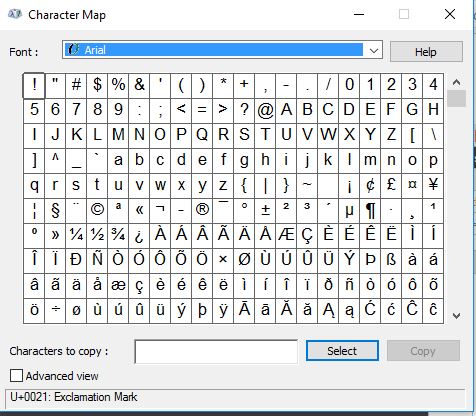

I don't remember what the ascii codes are, are you sure you have them right?   I typically just cut and paste from the charmap.

I always for get how to do that.  Can you refresh me?
Wed, Mar 29, 2017 at 4:10:54 PM | ASCII Symbols
3.5 Stars: 399 Votes
Are you on window's 10?  If so then just click in the lower left corner and in the window type charmap.
Earlier windows, just type charmap in the windows command promp also found under the start button.

That works great.  Thanks for the refresher.
