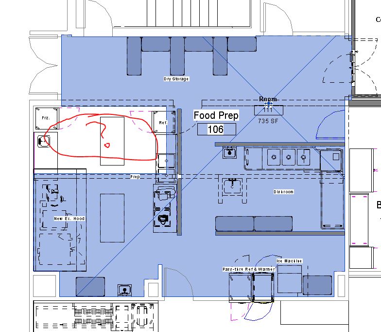

See screenshot- its capturing most of the room, but not the area highlighted. What gives? Can I change the room boundary manually?
You can see I have some existing/demo walls/doors set up. I turned the phase filter on so you can see it. Another interesting part is that he area I highlighted with my red question mark, the room tag sees that as two individual rooms side by side.
Thanks for any insight you can give me!

Rooms and walls are phase related.  If the room was placed before the demolished wall, then the room ends at the wall.  Experiment in a junk project to understand how this works.  You may need rooms in the later phase.
