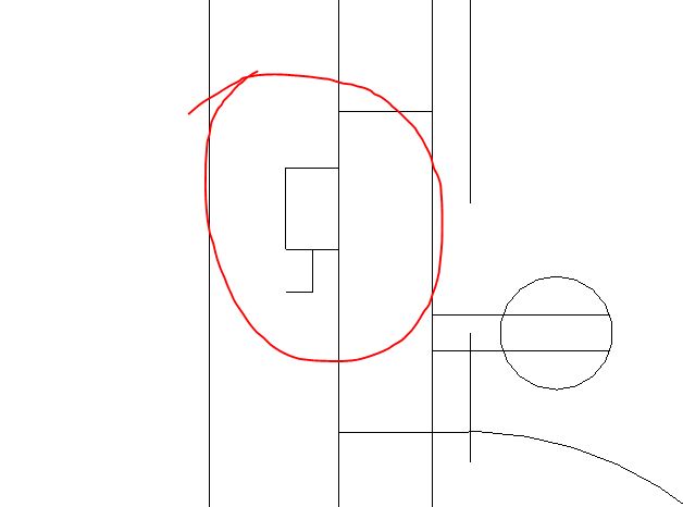

Thanks for your attempt at steering me in th right direction but after trying some of those things and showing to my engineers they said, they want it to look and act like it has in AutoCAD for the last 2 decades we've been using that!  The blocks we've created and have been using for a long time are the way they want them and the engineers don't accept the fact that Revit doesn't behave like AutoCAD they're saying make it work!  I've attached a screen shot of the way it's supposed to look and the way a generic annotation looks in Revit.  That's fine!
The files attached show; 1. How the generic anno looks and the way we want it.
2. Shows what the the current familes plan view anno looks like.
The problem is quite clear and there must be some formulaic work-around to this problem.  If we can forget the rotating part and just get the anno family to follow the devise as shown on the walls, and be able to turn on/off the ones we don't need when the engineer wants it or not, that's what we're looking for?  Any additional help would be awesome!

Creating the correct tag and family can look just like that image.  Obviously, the rotated views will be different - correct?
