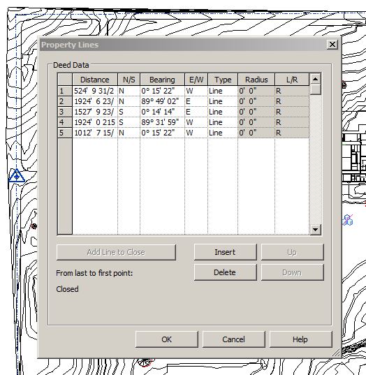

You said you had a site survey.   A typical survey has a base point, all property lines using bearings and distance, and it may include topographical information.  Under the massing and site tab is the property line tab.  Using that, you can lay out the property according to the survey.
I prefer to use the table because it is far easier to enter the data like the one shown below.

BTW,
I just cheated on a project to get an approximate real location of my survey point.  The survey showed the center of an intersection which you can see on my image above but no coordinates were given.
I un-paperclipped my survey point and moved it to that location but the NS/EW coordiates where not set correctly.   I went to google maps and visulally picked the center of that street intersection.   Not exact but it gives you real world coordinates good enough for sun studies.  With the suvey pont still un-paperclipped, I set the coordinates and the survey point moves.  Now you can re-paperclip it and move it to the correct location.
In google maps, you can enter the NS,EW coordinates and it will go to that location.
