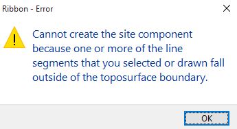

I've watched several tutorial videos on using the Site Designer plug in software.  I built a simple topography in Revit.  It doesn't matter if I try to build a street from existing model lines or draw the street on the topography, I keep getting an error message that says one of the line segments that I selected or drawn is outside the toposurface boundary.
What am I doing wrong?

When you create a topo from points you place, there is a boundry that is formed.   You cn not place new points outside that boundry.   You can grap points along the edge and drag them out to change the boundry.
