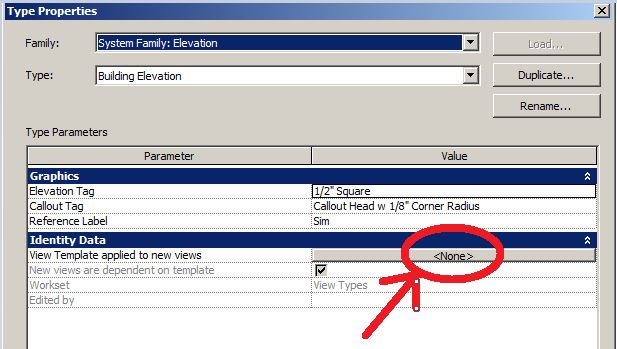

wondering if theres a way that when I place an elevation view or cut a section view that I can pre-set a view template to said view? as apposed to what I do now having to place each view and applying said view template to each view. just want to expedite the process.
Thu, Jul 2, 2015 at 2:31:09 PM | view template applied to each placed view
3.5 Stars: 399 Votes
View type setting.

THANK YOU
