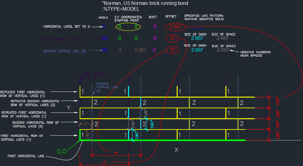

or better still you can learn to write your own pat files (see attached description)
__________I'm the guy they come to when they didn't follow my recommended workflows.__________ |

can u create a pat file for me? the examples are here
