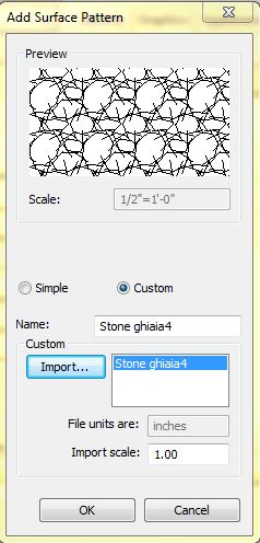

I need a stone hatch pattern and am downloading .pat files from here and elsewhere but when I import them, they all appear corrupted in the Preview window and aren't showing up properly on my surfaces. Attached is a screen grab of my dialog importing the hatch with shows what's going on. I've tried a couple dozen installs with always the same corrupted result. I'm porting them as "model" hatches and the files all appear to have the requisite Revit text added.
I haven't done much hatch pattern importing. The process seems straight forward but maybe I have a setting wrong somewhere? E.g., maybe I'm in metric and these hatch patterns are in a different unit?

Thanks for the thoughts. Turns out it was a newbie mistake and I hadn't noticed the scale factor at the bottom and it was importing with a scale of 1.0. When I bumped it up to 24.0, it looked great.
