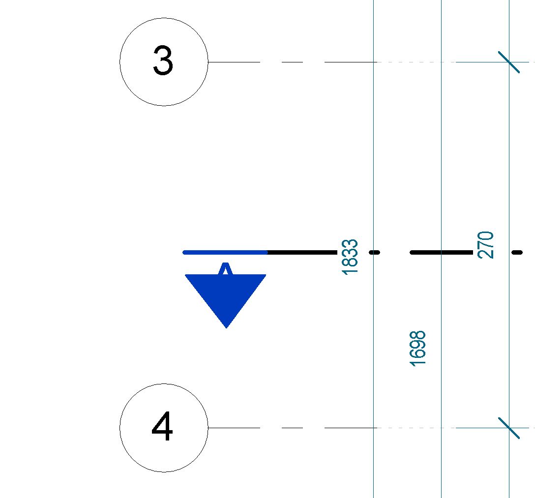

Hello everyone,
We are trying to create our own section mark but as you can see from the images below(1,2), when section mark flips, it blocks the label which is identified inside the section mark family. Do you have any idea how to solve this problem?
I attached 2 image files and a family file.
I would appreciate it so much if you have any idea...

the label in section mark doesn't rotate , its a revit limitation , and it's not justified but it is what it is at the moment , so you have 2 solutions :
1- is that you make a different type of section for each direction ( either differnt family or use some visibility parameters to create different types within the same family )
2- is that you adapt office standards to something that doesn't need the label ( text ) to move when you flip the section ( which is easier and makes more sense if you can take such a decision )
