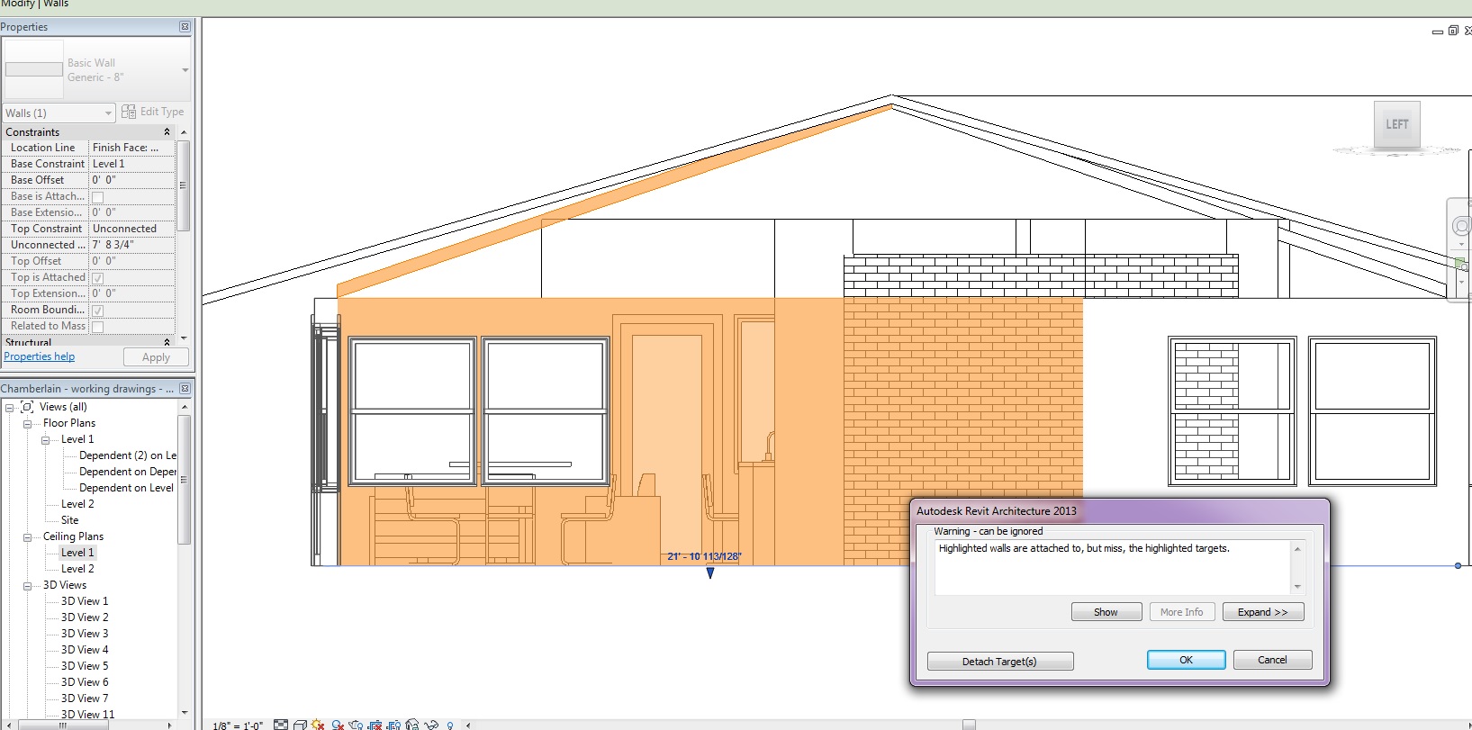

I cannot attach the walls to the vaulted ceiling or roof, when I select "attach top/base" I get an error message.  I am using Revit 2013, and have attached a picture with the error mesaage.

The roof / ceiling geometry is NOT completely over the wall.

How can I fix it? I expanded the boundaries of the ceiling and it still gives me the same error message. Thanks!

Show us the plan of the sketch that also shows the walls.
