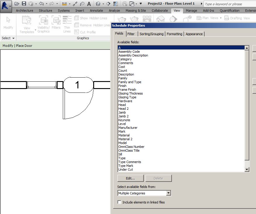

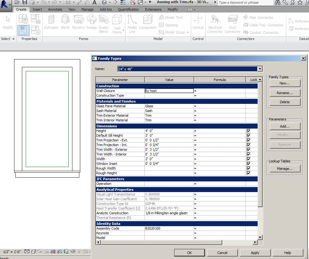

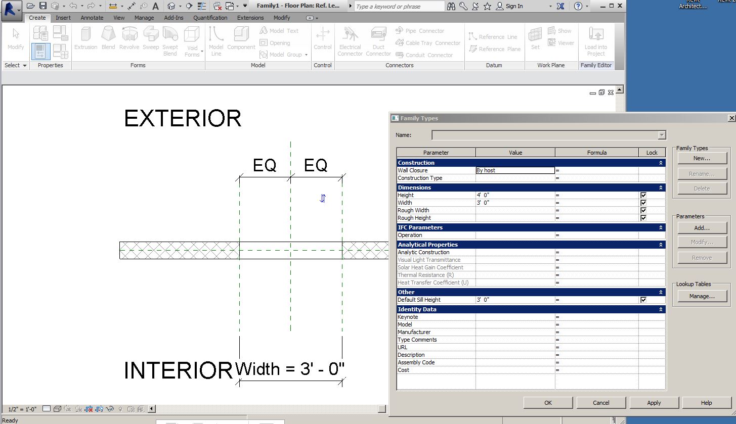

  1. Open the window template which I have shown in the image below.   Here are the stock window parameters.
  2. Open a stock window like the second image.   Now you see a lot more parameters but if you examine most of these you will see they are family, not shared parameters.
  3. Open a blank project, place a wall with a window then start your window schedule.  Now you will see what shared parameters are available with the window you used.

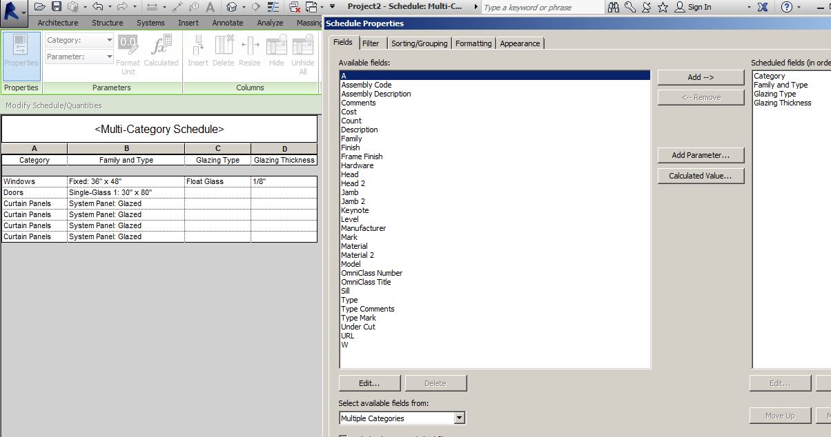

All different categories and these categories don't have very many shared parameters that are the same.   So you now place a door in your test project (I used commercial template) and using a multi-category schedule you see the next image. Note you see Glazing type and Glazing thickness.  Those could be what you want but no glass area.
I added a curtainwall to my test project and did my schedule.   Last image.   I had to edit the type of the window to change the glazing but this information is not available in doors or curtainwall.  So what do we do?  If ou look under project parameters, you see you already have the two glazing parameters but they are only assigned to windows.  Add curtain wall panels and doors and you can now use those.   Create a new shared parameter called glazing area, add it to door / window families then open the family and add the proper calculation.
