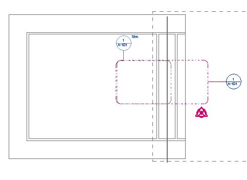

Hi,
Good day
We are currently facing numerous instances were callout (as shown in the image) extend beyond the crop view thus, extend beyond the titleblock. Our GA Plans were divided into 41 Sectors created from 41 scopeboxes taken to titleblock (Each levels has 41 sectors meaning each levels has 41 sheet drawings). Everything are good exept that when its time to blow-up drawings for particular area using callout, many of this are long that it passes through atleast 2 sectors, which give us unwanted result
How can we have a callout that span atleast 2 sectors but will not shown like in the image
Thanks

Thu, Jan 29, 2015 at 9:40:30 AM | CALLOUT THAT EXTEND BEYOND THE TITLEBLOCK
3.5 Stars: 395 Votes
I have added a similar view within the limits of each plan area and turned off the main callout.

Hi,
Until now this is still my problem and what you suggest makes sense
thanks for this
