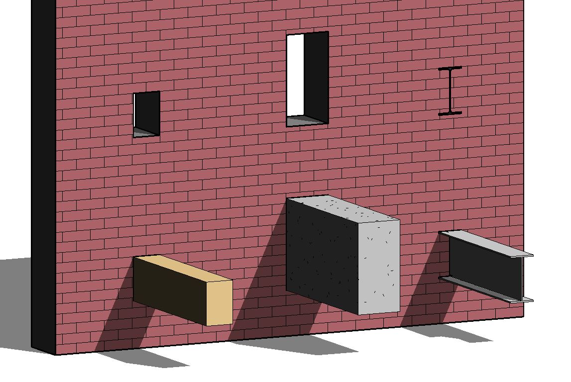

Concrete beam can be joined with a wall to cut a hole. For steel and wood beam it doesn’t work though. A void in these beam families works very well. Take a look at the enclosed file. Hope it helps.

Beam families in my file above have voids in them and are cutting the wall very well. The holes in the wall (see pic. above) are cut by the beams that are hidden in the view. There is no need for wall profile edit or detail lines. Take a look at them, if you like them, use them. They work for me, they work for Ron and I’m sure for many others as well.
