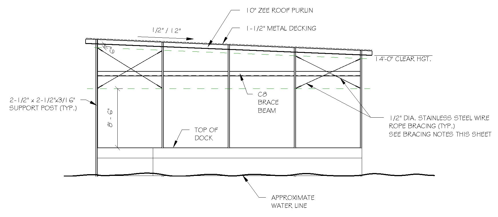

One more question if you happen to may have an answer.  I downloaded a wire rope from here on revit city to use to brace to columns at the HSS's.  They work great and look great in the section when I cut it but when I switch back over to my "overall" file (where I have my sectioned linked in with your help) the cables aren't showing up for some reason. They are modeled as a generic model family.  I've attached a snap shot to give you an example.

Mon, Apr 21, 2014 at 6:13:43 AM | Linked File Section Question
gprakash
Joined: Fri, Apr 24, 2009
49 Posts
Try if maintaining same 'Detail Level' and/or 'Visual Style' works.
I am not 100% sure. But just give a try!
Mon, May 5, 2014 at 10:24:09 AM | Linked File Section Question
West1977
Joined: Mon, Apr 8, 2013
26 Posts
5 Stars: 1 Votes
Just realized I never closed this session.  Come to find out I didn't have my section mark in the right place.  I still had it on a bay that was unbraced.  It was 100% my fault user error.
