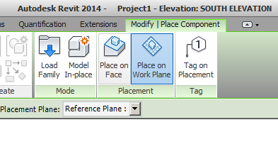

See attached.
Maybe you really need a face based family..... Use a face based template.

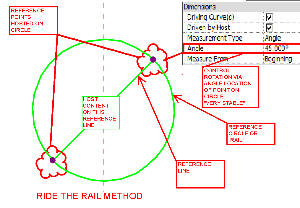

This is what am I trying to do:
I have object (see the image) and want to make parameter for rotation. I have to host this object to reference line. How to do it?

The only line "hosted" elements are built from a line based template.
Why can't you place a reference plane and use that?
What is that object? It would need to be a hosted family....

I am following tutorial, see pic in attachment. There is written: host object to reference line. How to do that?
