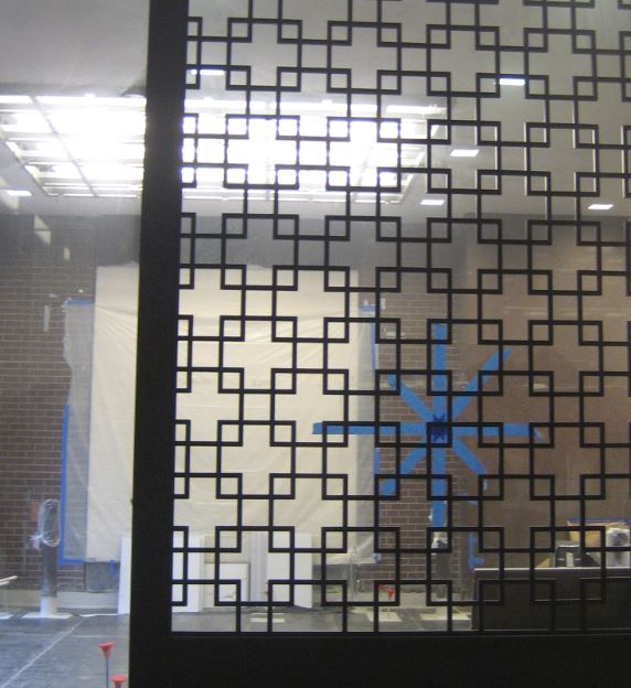

Hi,
I am using Revit 2014. I am trying to make wooden screen using a curtain panel and I'm trying to figure out the best possible way to build it. I've made curtain grids and a custom panel family of 4x4 squares/frame whatever you call it. But the real pain is I need to make custom panel for the ends (half panels) or can I acheive this automatically using parameters ?? This might a dumb question, but wanted to know if there is any efficient way to do this.
Thanks in advance !!

I would probably like to do this as a material.  Not modeled at all.

Follow Typhoon's instructions in this post.
http://www.revitcity.com/forums.php?action=viewthread&thread_id=20249

Never thought of it this way, looks great. Will try. Thanks WWHub !!

Either using parameters or custom size, in the end portion it will have an issue, try the guide provided by WWHub
