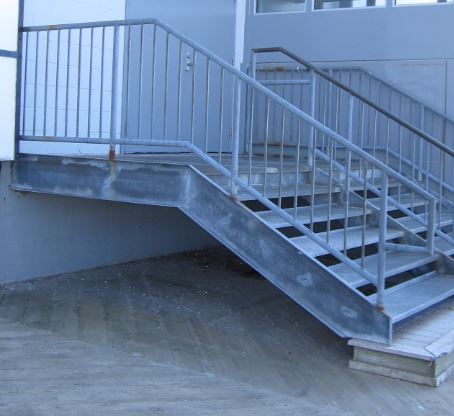

This has to be a simple question but I just spent an hour looking into this and am no closer to an answer. The default balusters for 900mm pipe railing and balusters in Revit 2013 are horizontal (see below). I need vertical balusters. I don't see where this is a setting or where I can load a different railing type. The photo below is the railing I need to model. If someone could clue me in I'd be most appreciative.

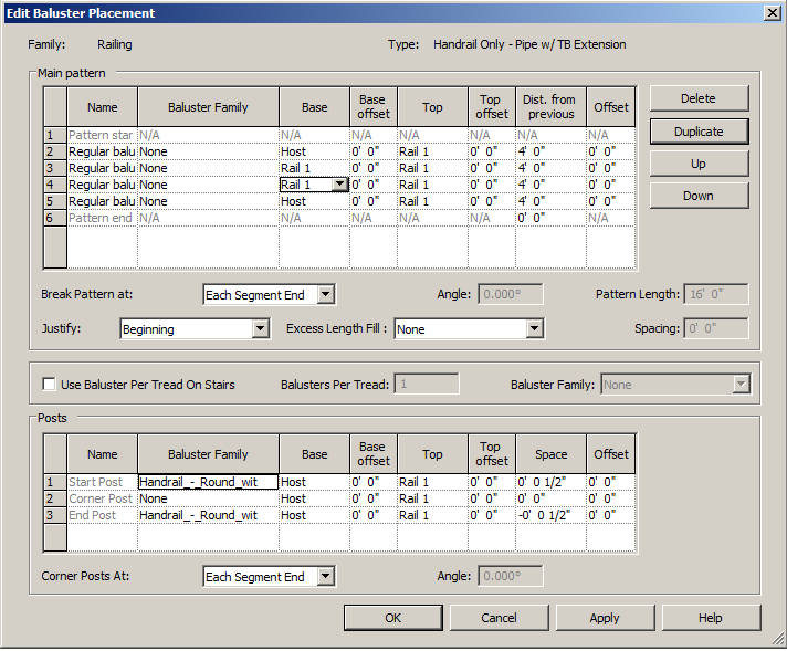

Sorry, the photo didn't insert for some reason. Here it is:

The default you show has multiple rails. Ballusters are set in a different window than the rails. A balluster can be hosted by the host or any rail location.

Ah. Light dawns. Many thanks.
