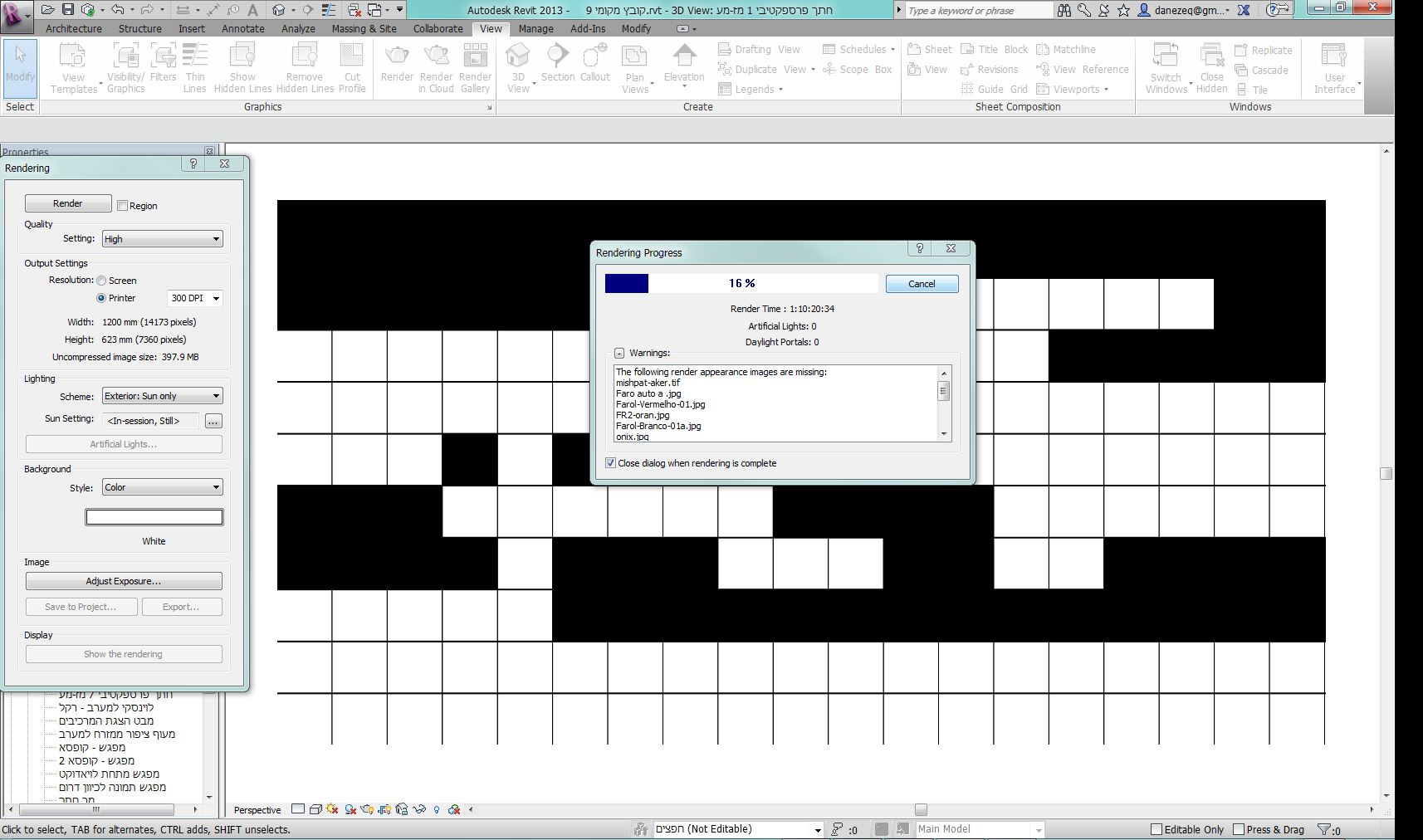

Do you think it's reasonable to continue redering in my computer? look at the time.
that's a really big image.
the computer is quite strong:
18G RAM (1333MHZ)
motherboad: Gigabyte x58a-ud3r
cpu: i7 950

Look at the size this rendering will be.  Do you really want these settings?
Obviously, you have some elements in here that are too finely detailed.  Is that a really intense pattern that ends up rendering black?  Maybe you have some model elements you need to change.

Yes, this is going to be a poster in size of 1200X600mm
and it is very detailed indeed.
1. i turned off irrelevent worksets.
2. i putted only the relevant part inside a section box
i need all the rest.
maybe i have some other mistakes?

you should get a tesla card if you want to render larger models..... depending on the nature of your business obviously as they are pricey but they slash rendering times and dont mess your computer up/ slow it down leaving you to continue with other work. Smile

that thing designated for  regular home pc? cuase that's what i have
