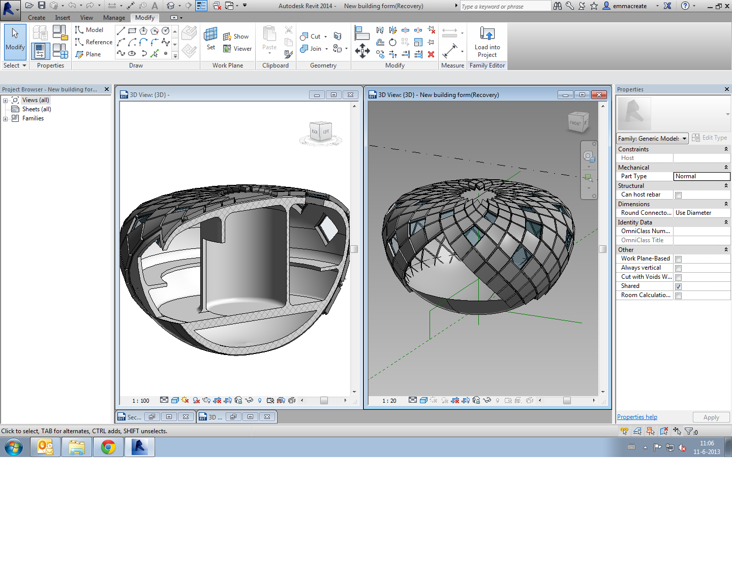

I am working on a spherical pavillion project that the interior and external form has been made from a single revovle. the design involved the exterior having a pattern diamond pattern that adapted to the buildings form. the problem i had is that i am not able to create a a solid revolve form and then divided the surface to apply the diamond adaptive family i have made.
currently the form has been made as a casework component revolve
and the exterior shell with has been made as a generic adpative family. the main problem is a cant divide the surface of a revolve in the component. and within the family it will not allow me to make the full revolve form of the interior.This design is going to be built by creating a mould to cast the design in concrete which means the company require a single element for there CNC MAchines to work from not a model made from two elements on top of each other  has anyone got an idea how i can create this form as a single element?

i'm not sure i understood..
but i think this post by Zach could be helpful...
http://buildz.blogspot.kr/2012/05/repeat-and-divide-prt-i-curved-panels.html

Create the revolve in "Conceptual mass" environment then you can divide. Zach Kron blog is very, very good....
