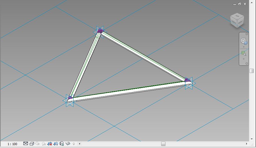

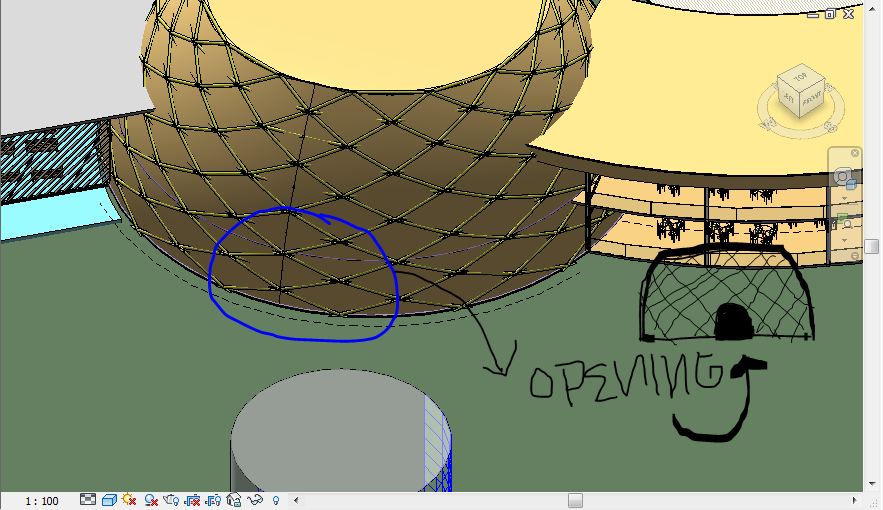

Hi all, I start a new project with massing in-place mass (pic 1), a semi dome building , by using divided surface, I load a panel triangular like space frame family(triangular flat pattern) (pic 2), use wall by face to fill the empty space, it worked just fine but then I need an opening in front of the building (pic 3), I was trying to use edit in place then created void but it didn't work.. I'm fine with the imperfection of the opening, it's a studio project
Is there anything I can do to delete some of the triangular panel family, or is there any better way to make an opening using edit in place? thanks in advance guys, oh btw I'm using revit architecture 2012

just make opening you want at in-place mass with void form before place patterns.

Hi dingohot, thank you for replying! and a bunch of thank you again for your suggestion, it works like a charm!
