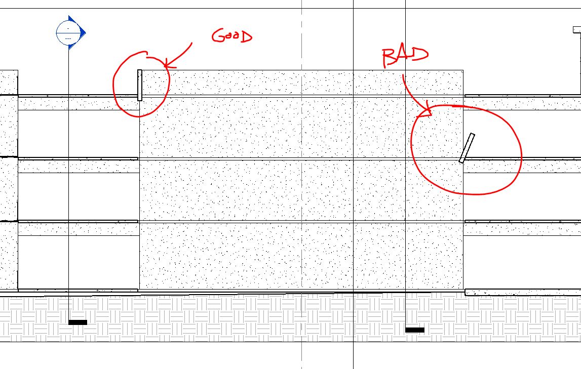

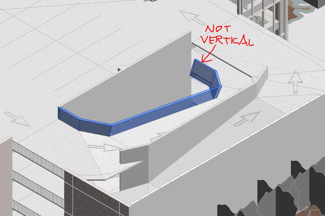

I cannont manage to get my sweep profile to remain vertical- it rotates with the angle of the picked 3D path (see attached). I have tried skething the profile, and creatign a profile family (both with and without the "rotates with component" box checked).
Any thoughts?

Using walls would be much more labor intensive, and if I decided to change the profile of the spandrel, like say to put a reveal in it, I'd have to model the reveal out of sweeps anyway (wall sweeps are either vertical or horizontal), which would give me the same problem:
Sweep profile will not remain vertical.

Is this a floor edge sweep instead of a model in place sweep?

I have tried it both ways. The floor edge sweep won't work with the slope, only on level edges. The in place sweep tilts over.

Swept Blend is the way

yeah... I was looking your images (both of them) and you can do that easly with walls and a couple of ref.planes

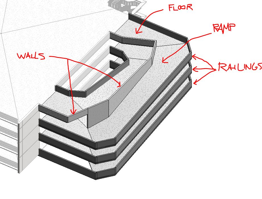

Using ramps and a profile family for the railing works well...
