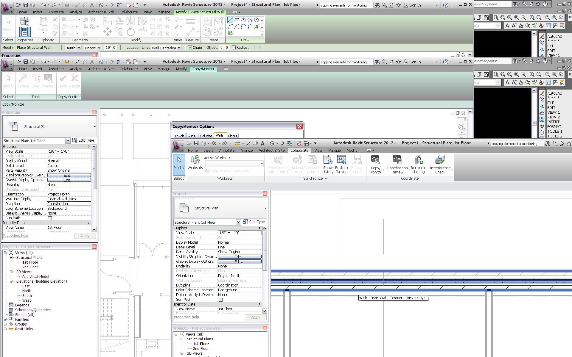

Below are my steps (maybe something is wrong)
Yeesh - Where is My Cad
