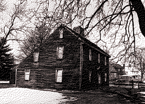

I would think roof by extrusion would be the easiest way. BTW a saltbox is roughly a small square house with a roof starting on the first floor top plate, sometimes lower, much lower, going up to the ridge, and coming back down to a second floor top plate. The theory is the lower roof is to face the north to divert the cold north winds over the roof. Post edited on 2006-01-09 19:39:00
Mon, Jan 9, 2006 at 7:42:33 PM | RE: saltbox roof
framerman
Joined: Tue, Jun 29, 2004
543 Posts
4 Stars: 13 Votes
Sorry, this would be much easier to explain.
