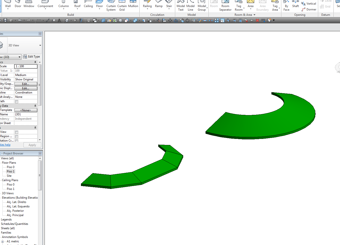

hiya how are you all? please i do need a help am having to design this project for a client and i have to make this complex roof on revit. And i have no ideal how to go about it any one got any video to show? please would love to have a look thank

what am asking is how to make such roof not the tile on the roof the sub roof is what am anxious about thank you

You mean this?

yeah exactly that please would you have a video for that piece on how to make it

They are "Roof By Footprint", create the perimeter of those roofs like you can see in my images, define the slope you want to those eaves and that's it....
