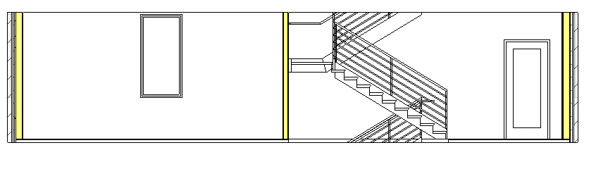

Your question is contradicting.  You say " the section box (not a crop region visible) in their section view" and "  the section box is ticked off (for the section) but it is not showing up "    <<< These don't jive.  Of course if it is off, then it won't show up!  So - what are you really wanting / asking?
The view below - looks like a section but it is not.  It is a 3D view using a section box with the box hidden but on.

He is adjusting that in a 3D model!  So I still don't understand what you are asking....  NOTE:  My section has a section box... ON but hidden in view.  Please remember that section boxes can be controlled on/off in your VG annotative settings.

Pay attention to what he is doing.  While the 3D View is open, he "activates the section box".  That means he clicks on it.  Now when he switches to the section view, you can see the section box because it was selected in the 3D View.  Understand?

I tried it this time and it worked. I think it's because in the 3D image, not only does the section box have to be blue, but you need those little adjusting triangles (that make the planes move to and fro) also have to be on (visible). Once they're all on, the section box shows up in the section as well. Also, if you click on the white of the section view, poof the section box disappears. You're absolutely right.
