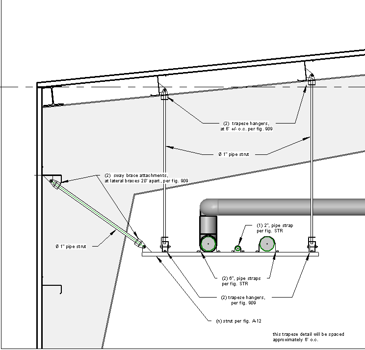

Rather than make a family for this type of structure, it is easy enough to model in place the simple frame and then copy it to the four or five locations in the building much like I did below.

I've done pre-engineered metal buildings using the families here on RC but your building is considerably different.  If you are doing more than one building like this, then do create a parametric family.  Otherwise, I would not model in place but I would model a fixed family that can be placed in the project.  Model-in-place elements are meant for one-only placement (but they can be copied - just not good practice)

Not to argue with the master WW, I would say that a simple tapered truss can be modelled in place in about 20 minutes and unless one is really conversant in families it will take all day to create a family worth doing.

If you can model it in place, you can model it the same way in the family editor - same process only easier.  Families don't have to be parametric or have any parameters.  The most important advantage of modeling in the editor is that  your workplanes are easily defined.  In the project, they are not.  Also, changing the families is easier in the editor.
If you are in the project and you want to add something - especially if a different user, again, where is your work plane?  What if you picked a frame modeled around col 1 workplane but this was a copied one at col 2?

Good point WW, I was thinking about making them parametric which is very difficult. Because the slopes and angles change.
