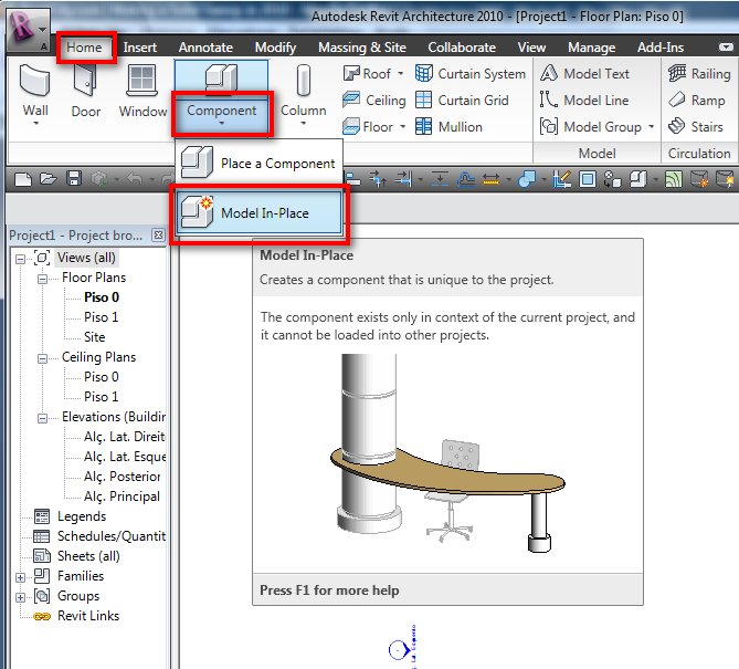

Not sure what you are doing.  If I had special trim I wanted to model on walls, I would do in-place sweeps using the wall as the host and sketching arount the openings for the path.  When you do that, you can pick your profile and place it where it needs to be to do the sweep.
Be careful, sweep paths usually need to be on the inside of the profile.  In other words - if you had profile to go around a door and you picked the edges of the opening for the path, the profile wants to be on the wall side, not the opening side of the path.  That's because the profile can't turn on itself.

Don't do it as vertcal and horizontal sweeps because they will not join correctly.  Do it as an in-place sweep.  Start here:
