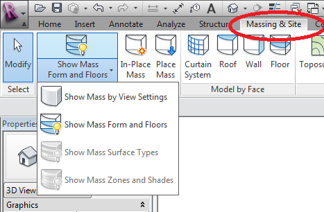

Fri, Jul 15, 2011 at 1:46:11 PM | Conceptual Mass Project Space Visibility
AbsoluteBIM
AbsoluteBIM Avatar
Joined: Fri, Jun 17, 2011
220 Posts
4 Stars: 4 Votes
I should have included a picture, try toggling bewteen the different 'show mass' options as shown.
