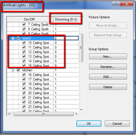

I'm trying to render a seen contains 800 lights,
It takes too mutch time in rendering.
is there any option to reduce the time of rendering ?

800 lights? Wow, that's a lot of lights, you will need to "Group" those lights in diferent names (by rooms, levels... whatever) then before you render you can "turn off" some of those groups you don't need in your render scene.

Good Idea but I have 14 Villas as a revit link >>>
How can I do it ...??

also trun on the section box and cut away the parts of the model not needed.

Thank you it is working ...
