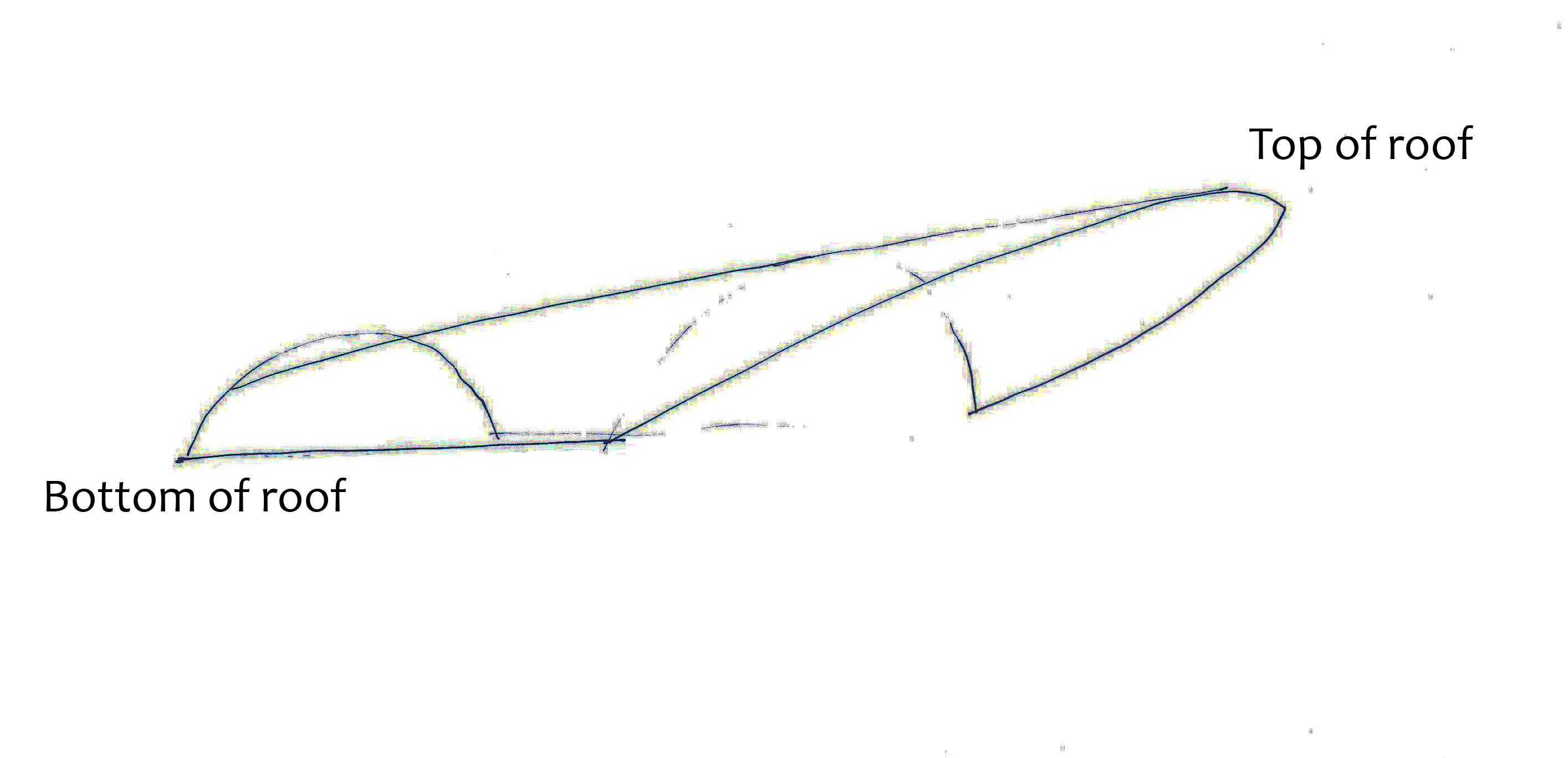

Hi there, -- I think that I can offer some suggestions on how to model this with the basic tools, if that is more appealing to you.
I see no parabola in this model, only a hemisphere cut back at an angle!
 You can model this in two moves -- One, being an arched sweep, the path running up the ride of your roof from back to front, and the profile being a hemisphere, and the 2nd object being a void to cut back the lip for the nice parabolic-looking overhang it has there.    I'll upload a pic in a bit after I leave work to illustrate what I mean.
Though... conceptual masses can look pretty sharp... I think this geometry is really quite simple.
Okay, this was ~10 minutes, the orange shell is one sweep, there's another sweep with a path along the edge (gray) to soften it and give a curled-over look, and the void is invisible, but extends from the upper tip to the underside of the roof where it behins sloping downward.  If that's somewhat clear.
