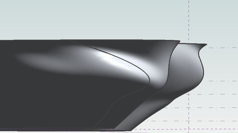

I am creating a blob like form from lofted splines in Revit 2010 and then dividing the surface to create a custom curtain system.  Do to the complex nature of the shape Revit does not loft the form as well, or with as much control, as Rhino can (see pictures below) so I want to use Rhino to create my forms.
I exported as a .sat file, .dxf and a few others from Rhino and can successfully load them into Revit.  However, when they load in they load as some sort of group and I can not select the surface to add dividing lines to it.  Is there anyway around this?
Thanks for the help!
