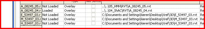

I discovered something odd yesterday when reviewing one of the models I principally control on another person's workstation and can't really make sense of it.
Essentially we've our Architecture model, with adjacent architecture models linked in
When I've linked these models I've navigated to them through my desktop shortcut (to their folder location on our network) using a relative link (as our partnering office in Oz have adopted the same folder tree layout) since all's worked well on my machine I've never really looked at the path...
 ...but when the links dropped out for the other person yesterday I had a look, and the path for the models goes "through" my C: placed shortcut (breakingthe link obviously)
How can this be avoided? Navigating to paths via network drive shortcuts is a bit tiresome with our server system - but a necessary evil if needs be I guess?

I don't think you have a choice but to set up the initial link (or re-saved link) using the full network path.

 I wonder if your user saved their work while experiencing a lost network connection. This can cause link issues.
I had similar problems with our consultants models. They have a completely different folder tree. I fixed it with Reload from... find the consultants model on my network, and then Save Location.
The only occurence of this problem since then has been when somebody takes the models out of the office to work on them where they lose the relative location for the links, Revit defaults to the local C: location looking for it, and then they check the work back in, only to mangle our link paths. We have learned to control the offsite work/link mangling problem by allowing users to take home a checked out workset that includes full relative paths and links.
