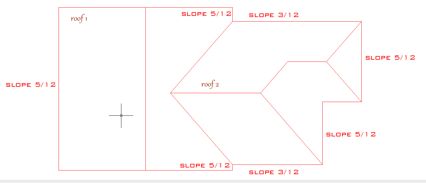

Hello,
Can someone please show me how to build this roof? I have two pieces of roofs: Roof 1 has a 5/12 slope and roof two has 3/12 and 5/12 slope. I was trying to build this roof by footprint. I wanted to build two pieces separately and then join them together, however  I don't know how to build the second roof?
Your help is highly appreciated. Thanks!

Build this as one roof.  Just add the slope definitions to each roof edge ept the two gable ends.

THANKS SO MUCH WWHub.
It worked!
 I really appreciate it. You saved my day.
