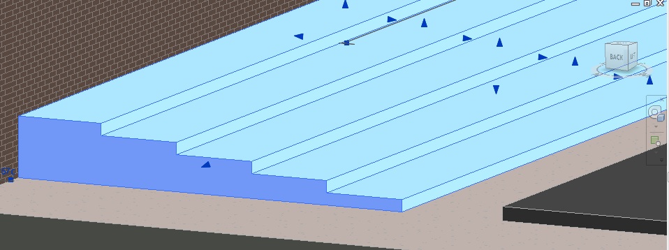

I have modeled an In-place Floor for my raised seating arena. (as shown in the picture).
Now i am trying to put railing on this floor using RAILING tool.
and it just doesn't allow the floor to be picked up as a host.
can we not put a railing on in-place floor???
How do i place a railing on a floor like that.....
Please help, it's really urgent !!
thanks to all

The best you can do is create a very thin slab with that slope to host the railings then you can Hide that slab.
