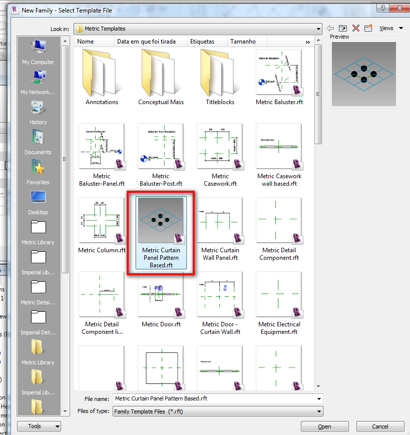

 We have an irregular shaped curatin wall, I modeled a project specific panel family and loaded it into our project to replace system panel. When comes to the regular shaped panel(rectangular shape), the coustermerized family replaced the system panel easily, but when comes to the irregular shaped panel(mainly exist at the edges of the curtainwall, where the panel is no longer a rectangular), Revit refused to replace the system panel with the panel I modeled. Is there any way to solve this?

You didn't said if you are working with 2010 or 2011 because in both you have the new "Conceptual Mass" family but ONLY in 2011 you have the new "Adaptive component" family, you must use the "Metric/Imperial Curtain Panel Pattern Based" family, Revit warning you about that situation when you try to do that....
