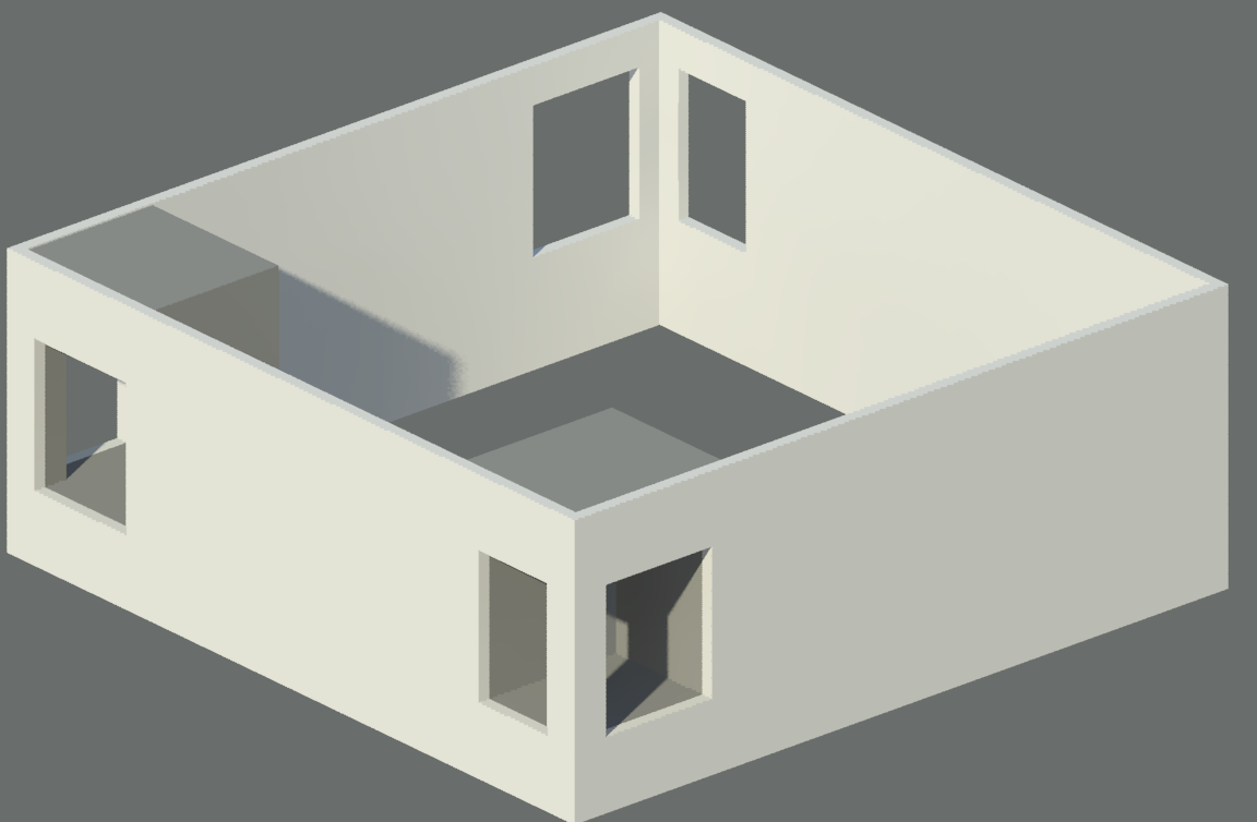

Hi I'm trying to make a family that cuts through 2 different walls (any family will do, but I'm using a wall based family right now).
The Walls are placed at a 90 degree angle. Does anyone know if this is possible?
See attached image.

I wasn't clear about my intentions there. I want one hole in one wall and another hole in the other wall.
Just like the hole in the image but on the other wall.
As it seems one need to fool the family by making an L shaped void that just barely cuts the corner.
Does anyone know if there are any better ways of dealing with this.

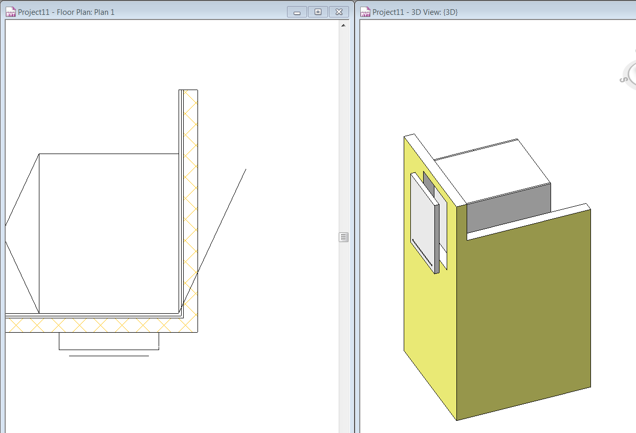

Take a look at the corner window family and use that as a basis for your family.  It is wall hosted and cuts two walls at a corner.

To Mcantwell,
Does your family cut through both walls just by placing it?
I'v tried yours but it won't work here.

I couldn't get text into the post above.
The file has a quirk. It doesn't initially cut the return wall. But if you slide the fixture along the wall until the host opening cuts the return wall it cuts the return wall. When slid back into place both holes cut. Don't know why.
