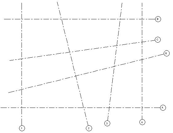

 i have a complicated building in which my gridlines are not parallel to each other.
When i draw them the way i have attached in the image... i can't see my grids lines(those which are not straight) in elevations.
I only see those grid lines which are either horizontal / vertical.
What can i do to have all my grid lines visible in the elevations???

Bansri, this is what you need to know: http://designreform.net/2008/05/revit-missing-grids-in-elevation/
Watch this great video from David Fano / Designreform.net
