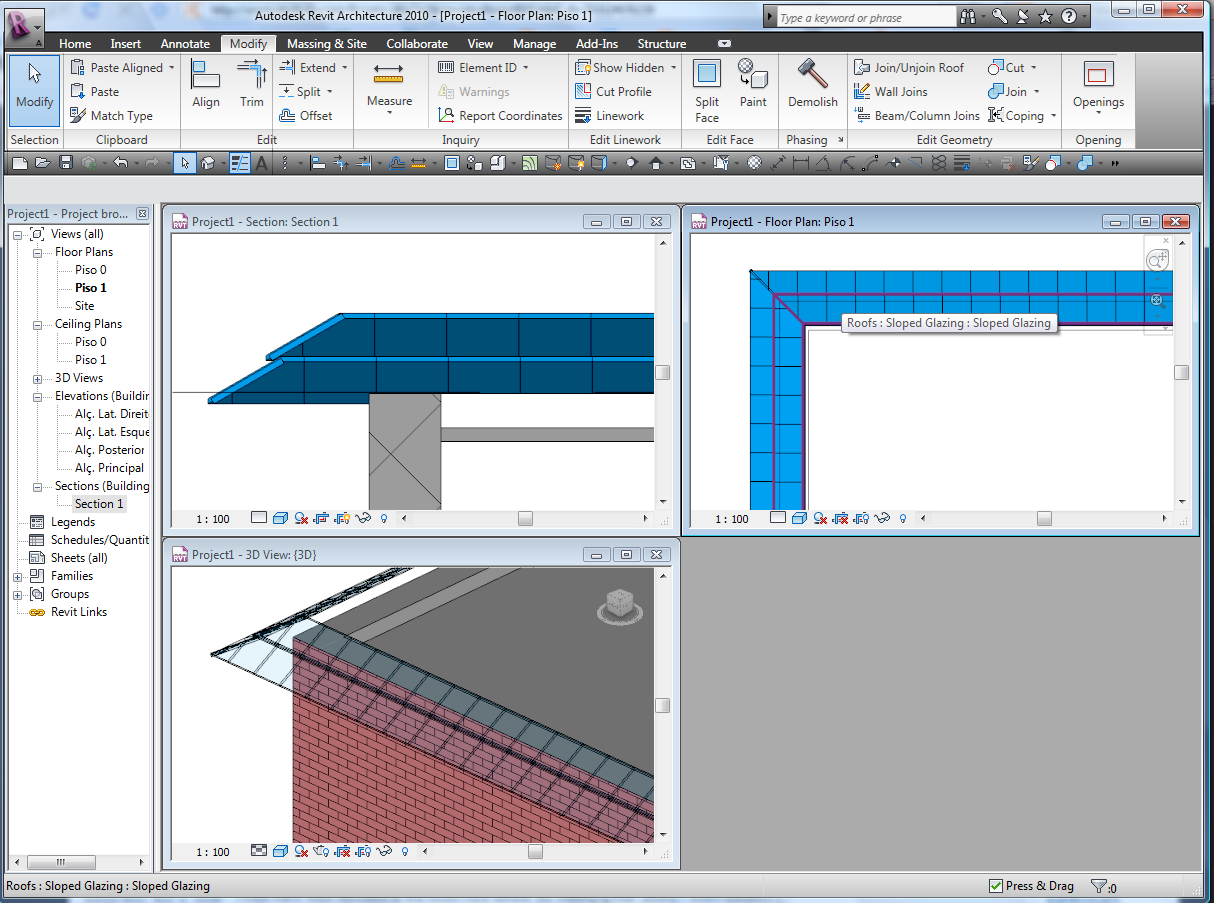

Look this family I post, you can create another family like you want to use in the ridge tiles.... to create the main roof, i think i use (if you don't want to use a simple texture) the "Slope Glazing Sytem".. Several slope glazing that overlap each other like in the image...

 i was trying to use the sloped glazing for my roof tiles. i can place them correctly in the middle, but when they meet corners where they need to be cut to fit to a different shape; revit does not accept the family and replaces it with the glazed panel.
How do you make the family that cuts the corners in the sloped glazing...?

Sometimes I use Sloped glazing system but to not increase the file size i use only a texture to the main roof then i apply the ridge and so one with this families i just attached.. also check this site for textures: http://www.cgtextures.com/
