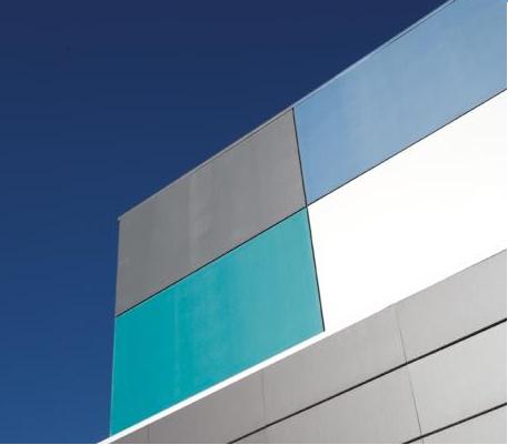

Say i want to detail different colour panels on the external wall of my model, how do i go in doing so? So the panels are similar to what the attached image is like.

Use the "Split Face" and the "Paint" tool to create that effect

Thanks Typhoon. It comes up with "Lines Cannot Intersect Each Other" when i try to do more than one panel at a time.

Ok...watch this: http://www.megaupload.com/?d=5XOXI970
