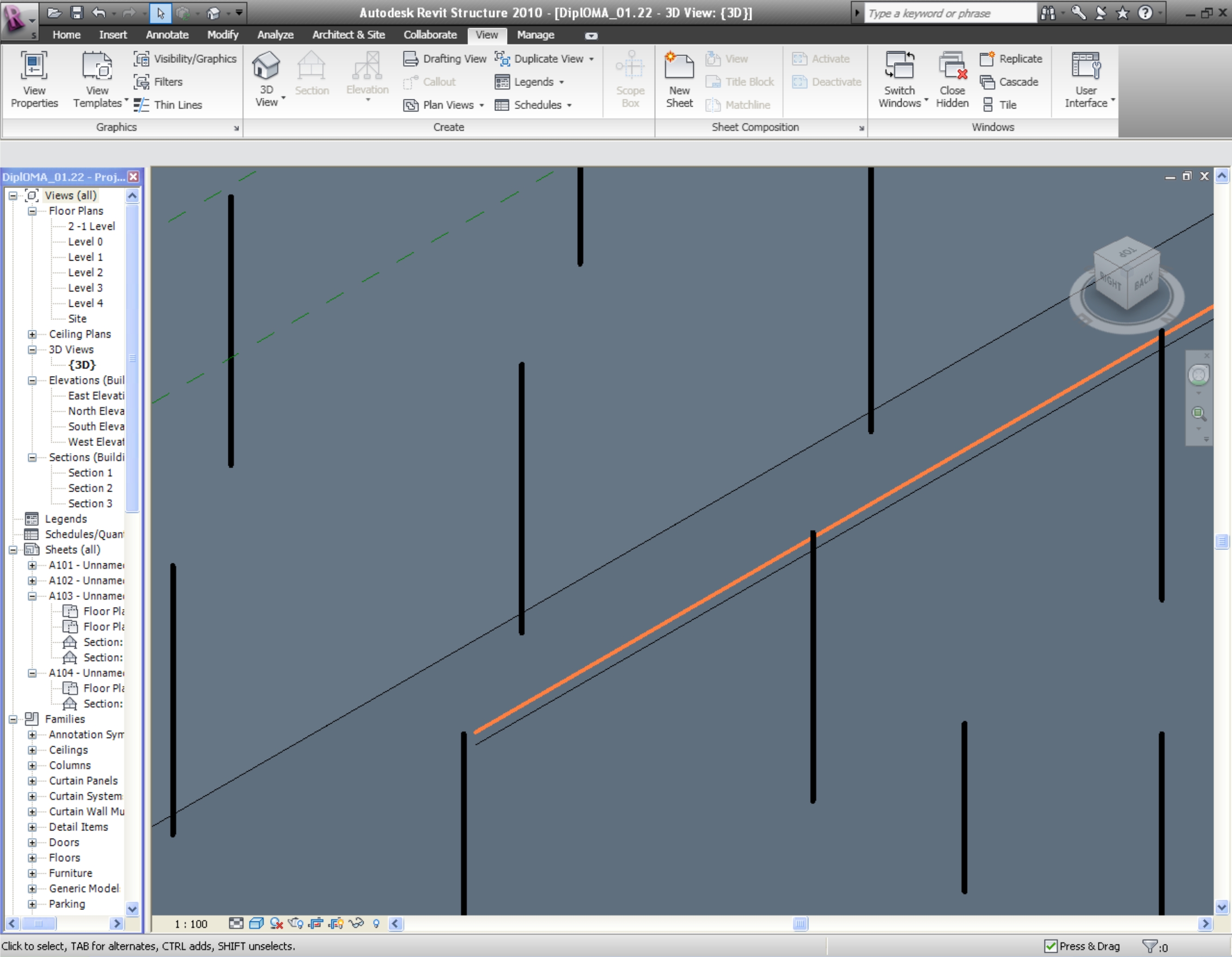

I am trying to build a simple metallic structure in Rac.
The problem is that I cannot see the columns, beams and braces as they are in 3d view or even plan view. I see only thin lines. [picture attached]
I opened the project with Revit Structure and I have the same problem. Only if I copy the structure to another new folder it seems to be right. So, I concluded that the problem in inside the file setting but I cannot imagine where should I look.
I need the file for 3dmax and as I import FBX from Revit the metallic structure disappears completely.
I use R Architecture 2010 and R Structure 2010.

You need to spend some time understanding VG.  Turn on/off the various switches under structural for analytical model / stick symbols.

I switched on all the analytical model and stick symbol concerning structure, it doesn't help...

I have detected the problem, the detail level was coarse that's why I couldn't see some of the objects...
Now everything works just fine. Smile
